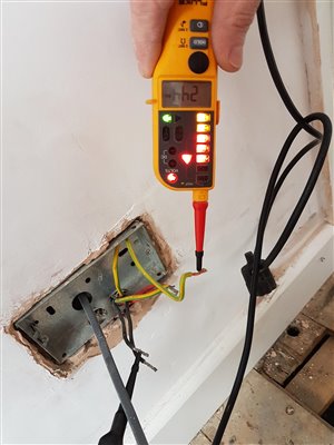

    To be honest when changing a light fitting I will connect the tester to check polarity,  loop impedance and then trip the RCD if there is one before taking down the old fitting,  then walked back to the consumer unit to isolate,  then confirm the fitting is dead and so on and do forth.  Bearing in mind there's lots shoddy wiring out there to catch out the unwary, like the Bulgarian builder who dismantled this socket fitting and the bathroom fitter who pulled the cable into the back of it.

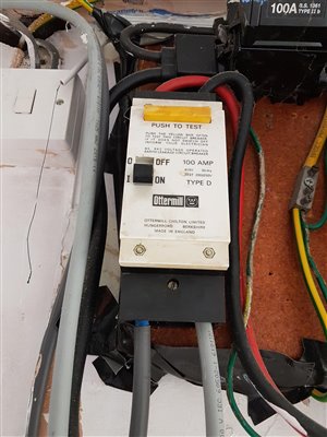

  • I'll bet you any money that those RCBOs are not tested monthly!

  • Chris Pearson:
    The single pole RCBOs are all in the off position, remember the bit about single pole devices having to be in the live conductor, that's not much use when there is reverse polarity on the entire installation.
    Andy B.
  • Sparkingchip:
    Chris Pearson:
    OK, so the tenant diligently presses the test buttons and nothing happens; but the lights come on, the telly works, heaters get hot, and motors go round and round. Does he (or she):
    (a) notice?
    (b) think that it is a bit odd, but they are all the same?
    (c) ask a question in here?
    (d) panic?
    (e) isolate and request an emergency call out from the nearest qualified sparks?
