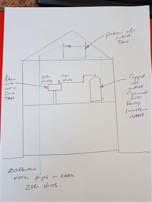

  • Supplementary Bonding simply means Additional Bonding. It is not a "special thing".
    Its purpose is to reduce the impedance between two simultaneously accessible items so that the touch voltage during a fault is reduced to a maximum of 50 Volts which is considered safe.
    If there is, for example, due to a fault, 200A (the current which will operate a B40A MCB in the required time. 40 x 5 = 200)  flowing in the earthed and bonded parts then the maximum impedance between two simultaneously accessible parts is 0.25 Ohms. 200 x 0.25 = 50.
    If it is more than 0.25 Ohms then supplementary bonding between the two parts will reduce it.
    With RCDs fitted the 200A can be discounted as the current required to operate the RCD is only 30mA, so the impedance can be 1,666 Ohms (50 / 0.03). Were the impedance to be above this 1,666 Ohms then SB would still be required but this is very unlikely.
  • A diagram that is as simple as it gets.
    A wash basin with separate taps can end up with mains voltage on the hot tap with zero volts on the cold, if you then hold both of them you are in trouble.
    A piece of wire as BONDING between the pipes keeps them at the same voltage.
