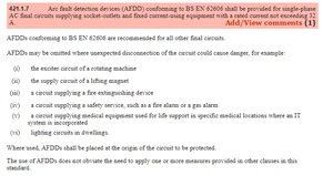

    thanks for bringing this to our attention.
    In the spirit of debate, it looks like AFDD are now compulsory EXCEPT for high current circuits? And not limited to dwellings, see screenshot below.
    (At the time of my posting, there is already one comment that this will increase the cost to customers, leading to people not upgrading CU's)
