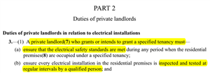

    Hi Graham, I’d like to agree with you with regards to the PRS Regulations, only I think that another, much more onerous interpretation may be easily adopted.  I.e. that the installation is required to meet the requirements of BS 7671:2018.
    That interpretation is one which a hypothetical (or real!) prosecution could quite reasonably and easily adopt.
    See Regulation 3(1)(a) of Part 2 (excerpt provided below for clarity), which says “ensure that the electrical safety standards are met. . .”
    “Electrical safety standards” are clearly defined in Part 1 as meaning those of BS 7671:2018.
    I think we all would agree that the wording of the PRS Regulations is poor and ill thought out, but I just wanted to make the point that simply testing in accordance with BS 7671:2018 will likely not be good enough given the wording of this statutory document.  Anyone choosing to interpret the statutory document according to what they think it should have said, is taking quite a risk.

    Bringing this back to PRS Regulations, what do people interpret to be the meaning of "electrical safety standards" then?  It seems unduly optimistic that a "BS 7671:2018" could actually mean BS 7671:2002 for example.  And the requirement for the installation to comply with "electrical safety standards," whatever the determined meaning be, relates to the installation, not just the test procedure.
    Should a tester feel secure in providing a clear EICR (i.e. with no C1s or C2s) for a rental property with an electrical installation that was erected to say, BS 7671:2002, and which is missing key features of later versions of BS 7671 such as a metal consumer unit, and (maybe) AFDDs?

    It's interesting that the regular inspection and testing by a competent person does not have to conform to the "electrical safety standards" ... the duty to comply with the "electrical safety standards" is left purely with the landlord as stated !
    So yes, the tester should feel secure in that - whether the landlord is happy with it is another issue, and one for the contract between the landlord and the competent person, I guess.

    The legislation is quite clear what it means at least on that point - "the standards for electrical installations in the eighteenth edition of the Wiring Regulations, published by the Institution of Engineering and Technology and the British Standards Institution as BS 7671: 2018" with a footnote that specifies the ISBN-13:978-1-78561-170-4 - so I don't see any wiggle room there at all.
    What's it's muddled up completely is whether the fundamental requirement is to pass an 18th EICR or actually meet every requirement of the 18th regulations - it says both yet we know they're fundamentally different. As it stands a it seems to me a landlord could get a satisfactory EICR and yet still be hauled up in court by a malicious tenant because the wiring had red & black cores.

    I don't think it's that clear Andy.
    The requirement is for the landlord to ensure the installation meets BS 7671:2018, and, where an inspection shows that it might not meet BS 7671:2018, rectify the relevant defects.
    BUT
    There is nothing in the legislation that says the competent person needs to check for compliance with BS 7671;2018 ... that would therefore have to be a matter of contract between the person ordering the inspection and testing, and the competent person engaged to do the work.
