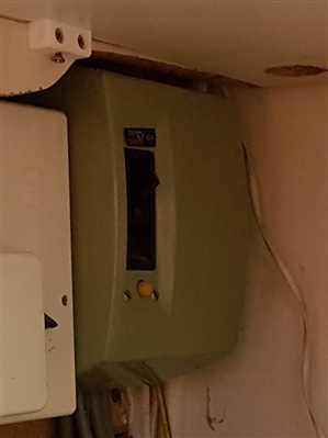

  • The big black VOELCB with the yellow test button is easy to spot as are most RCD devices.
    However there's some hybrid devices, RCDs made up using a VOELCB.
    Try this one from Wednesday in Devon, VOELCB or RCD?

    I'm going for 500 mA RCD in there Andy!
    Regards
    BOD
  • Today I tried testing the RCD and at 30 mA it failed to trip, at 150 mA it tripped in 8.5 milliseconds,  this was the point I checked what it said on the RCD.
    I had already realised there's issues with the CU but had only glanced at the RCD.
    There's not actually many electrical installations on the UK with adequate RCD protection.
    Regards
    BOD
    Quite possibly, I tried it at 30 mA and 150 mm without getting it to trip, so I fitted a double pole B40/30 mA RCBO to the shower circuit and wrote an advisory note.
    It is earthed TNCS-PME.

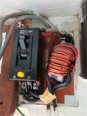

    One in South Wales from last year I posted a picture of before on this forum.
    The label on it says it’s a 0.5 amp RCD, just as Bod said.
