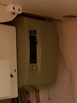

  • Sparkingchip:
    One in South Wales from last year I posted a picture of before on this forum.
    The label on it says it’s a 0.5 amp RCD, just as Bod said.
    If I saw something like that not sure ide know what to make of it thinking about it is it just a very large version of what you'd find in a normal 30mA RCD I've never seen anything like that before
  • There’s a surprising number of those 500 mA hybrid VOELCB/RCD devices still in use, as well as a considerable number straight VOELCB.
  • Sparkingchip:
    There will be many about as they were built to a very high quality standard and will work for decades. Regular testing is required.

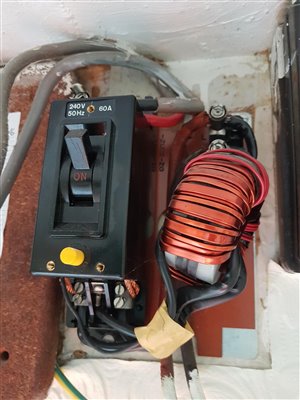

  • Sparkingchip:
    The big black VOELCB with the yellow test button is easy to spot as are most RCD devices.
    However there's some hybrid devices, RCDs made up using a VOELCB.
    Try this one from Wednesday in Devon, VOELCB or RCD?
    This looks like the Crabtree L60 model.
    Z.
  • Back then  (60s/70s) B.S. 4293:1968 required that current operated earth leakage circuit breakers should operate with an earth leakage tripping current of no more than two per cent of the rated circuit current. This would correspond to a current of 1.2 Amp. for a 60 Amp circuit, or 0.6 Amps. for a 30 Amp. circuit. The values typically adopted in practice  for a 0.1 second maximum disconnection time are: 1.0 Amp. for a 100 Amp unit, or 500 mA for a 60 Amp. unit.
    The 14th Edition I.E.E. Regs. did  not normally require operating currents of less than 500 mA.
    This protection seems to be mainly about reducing fire risks.
    But regarding shock risks, and a persisting fault current of 0.5 Amps. on a 30 Amp cooker circuit,  with an Earth loop impedance of about 120 Ohms, the shock Voltage is 65 Volts. Or with an Earth loop impedance of 80 Ohms is 40 Volts. The current operated earth leakage circuit breaker would clear the fault instantaneously..
    Z.

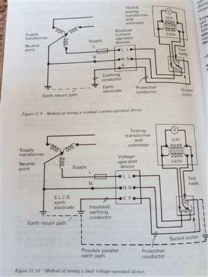

  • the test button on the 30 mA RCD can take both of them out.
    That makes it quite unusual nowadays.
    On a modern RCD the test button unbalances the sensor by connecting outbound live back to incoming neutral, rather than connecting live to earth, so any upstream RCD sees a normal LN current rather than L-E. Only the RCD under test sees an imbalance. The presence or absence of an earth is not an issue to the test button !
    You can play the same game with the RCD tester, and use upstream neutral as the tester earth if you need to test one RCD and not trip another. Do just check the LN polarity first though before spoofing a tester CPC from the live side.

  • I have found 30 mA versions, that’s why if I cannot see a rating label I put the tester on them to see what happens and some fo work.
