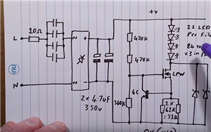

  • Also, Broadgage, LED lighting is not ohmic in response, so this too should not be a problem They are not a few LEDs in series with a resistor, even a simple light bulb has a full-on feedback stabilized switch mode power supply, so all bulbs at any reasonable voltage should be the same brightness. Dimmable ones are a bit different they modify the feedback by the mains peak voltage, to make them dim at all!

    A note against DZs comment above:
    Many  cheaper lower wattage LED fittings do not contain a regulated supply,  but a series capacitive dropper and bridge rectifier. They are cooler running more reliable and cause less of an EMC issue than some of their expensive counterparts. Apart from that they have nothing in their favour.
