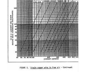

    I have screenshotted the graph below. It really  is that spotty in the original, sorry. Now this graph is not quite what you  need but let us slide along the 6AWG line to show the principles of how it works.
    So at the bottom of the line  a 30 degree rise (40C ambient, 70C core temp) gets you 75A.
    A 50C rise between air and core temp is more like 100A.  - so 20C ambient 70C core, or 30C ambient 80c core.
    150A is a 110C rise, so really the cable now needs running water cooling or a different sort of insulation, as for anything other than outside  in the arctic you will be damaging PVC, and can run it like that for a few hours at most before it will need replacement. The graph carries on up, but really that is for PTFE, mineral and silicone rubber cables, which you will not have.

    Thank you Roger another nice document, so PVC is A class and can go up to 85 deg. For most people building charging circuits on there vehicles they go by what the supply is stating. From what you have both said I would say 80 amps continues running is max this cable can take in open air but to be safe I below 70 amps would be better
  • Former Community Member
    0 Former Community Member
    Just to check if I am reading Mikes chart correct at 80amps and 30 deg ambient temp the core temp would be 62 deg is this correct
  • Roger, that is an interesting datasheet, & definitely one for the archive, not however plain PVC as per the OP..
  • Just to check if I am reading Mikes chart correct at 80amps and 30 deg ambient temp the core temp would be 62 deg is this correct
    yes - you go up from 80A to the diagonal line, and read across to 32 or 33 temperature rise. Add that to you ambient air temp to get the copper core temp.
    Do realise it is not quite right, as 6AWG is not quite your 16mm2, more like 14mm2, not a European size.
    The cable you linked to in the original post is rated at 70C, but I assume the temperature they are quoting the ambient at which the core temp is right on the limit for the quoted rated current - so at 100A perhaps 50 degree rise from a 70C ambient takes the core to 120C or so.Which is certainly pushing it if you'd like a long lifespan, and not good for anything near the cable either.
