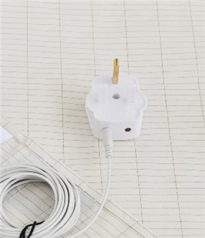

I came across these things the other day:
This is used for a ‘Grounding’ sheet with conductive fibres woven into it that you connect to the earth of a local 13A outlet.  Leaving aside the ‘science’ of any claimed health benefits of sleeping on a 'grounded' sheet, I wonder two things:
1: How compliant to BS1363 such a plug could be, as technically I expect it lacks many of the features required of a 13A plugtop? The best you might hope for would be that the pins (including the plastic ones) are of the correct size so the contacts in the sockets don't get deformed.
2: In a PME installation, with the risk of a broken PEN conductor externally, I'm not sure I fancy sleeping on a sheet that could potentially become live - albeit that if I haven't got a foot or hand out of bed, and everything else connected to earth at the time should theoretically be at the same potential…..
Would you sleep on one of these?

  • These seem, on the surface, to be similar to the ‘anti-static mats’ which have been a common precaution in the electronics world for decades.
    Hopefully the connection to earth incorporates a high value resistance (1meg or more) so that, should the ‘earth’ connection rise above true earth, the current flowing through a person in contact with the mat is very small. I certainly hope that the connection between the earth pin & the mat is not direct!
  • It would be informative to check if there is a suitable resistor in the plug or the lead.
    I believe the 1M resistor in antistatic workstation leads is mainly to reduce the shock if the user accidentally pokes a live wire on the equipment being worked on, while being connected to their antistatic wrist strap.
    But I can see it also protecting against PME earth issues.
    I concur, it is.  But it also has certain ‘reverse’ benefits - you wouldn't want to to tethered to a ‘hot’ earth by your wrist strap!

    I see no intrinsic reason why the fake plug should not be made accurately to conform with BS 1363.
    It's a sort of supplementary bonding device. I shall try bonding my antique iron bedstead and see if that works. ?
  • Provided that a resistance of one meg-ohm or thereabouts is incorporated then this seems harmless but arguably needless.
    In the absence of such a resistor then there is a small risk.

  • The plug for my anti-static work mat has three metal pins, an LED that indicates the earth is working and a label that says it includes a 1M resistor.

  • So it looks like one manufacturer states they have 100k resistance.
    The ‘science’ seems to indicate that these products facilitate connection with the ‘massive reservoir of free electrons’ in the earth which allows these to flow to our body to ‘balance the charge of electron-deficient free radicals’ that we all apparently build up!  Clearly you can get enough electrons flowing through a 100k resistor with unknown (but likely very small) potential difference across it to be effective……
