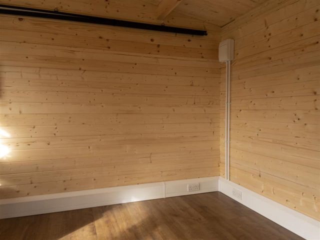

I'm planning to batten the interior of the garden room I'm building and line it with 6mm WBP plywood with the cables in the void behind.
Can I fit flush mounting mains sockets to the plywood or does this contravene a fire safety regulation?

  • It is fine but do use an appropriate back box, either a dry lining type or metallic

  • Bear in mind that if the cables are embedded on or in the insulation, then their current-carrying capacity gets reduced (sometimes quite significantly).
  • Yes I understand that, but the insulation is sandwiched between the OSB while the cables are on the surface.

  • Nice fresh circulating air is timber's friend. It reduces the chances of rot and fungus growth. Why not just surface wire internally?
    Z.
  • Good point. It would certainly be cheaper and a lot quicker. Not so neat but I can probably live with that.
    I've spoken to the SIP manufacturer and they say that the SIPs act as a vapour control layer and providing the room is used as an office and not as a gym or sauna no additional vapour barrier is needed.
