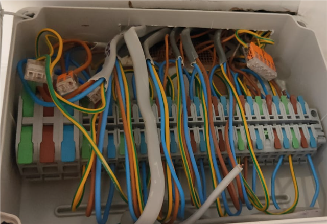

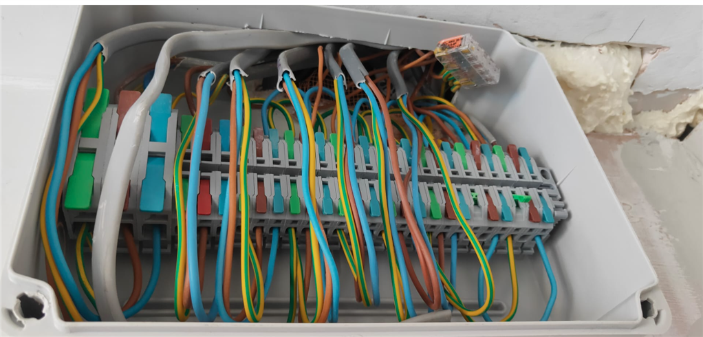

This junction box has been installed by my builder's electrical worker, the void above the box is the ceiling space on ground floor
is this acceptable for residential installation?

Thanks all for your input.
This is not the result of any equipment being moved, it is a collection of new lighting circuits in an extension that have been grouped together for connection in a central point. This box has been presented supplementary to all the hidden connections in the ceiling that were used to modify the existing circuits.
There is a lid to the box and access from above would be through the floor, so not an issue.

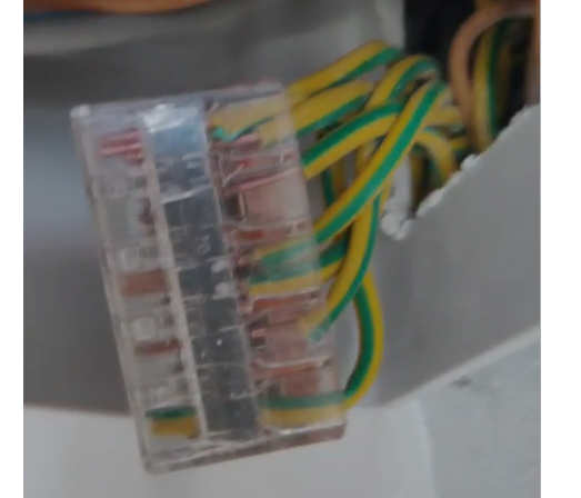

There are some unsheathed cables outside the box, I haven't yet been closer to pull them out, there is also a collection of PE in the Wago strip, I'm guessing he ran out of terminal space. I'm pretty sure one of these is clamped around the earth sleeve
The quality of the installation is just naff, including chewed out hole and spray foam, but I recognise that people have different levels and abilities of this. I'm not sure why the cables had to move from the original hole but I'm bored of asking my builder about cosmetic issues now.
My concern is the gaping hole, my understanding is that it is not appropriate for electrical installation and that the cable entries should be sealed to prevent the spread of fire.
So, the box is mounted on some boxing that runs front to back on the house, just the other side of the wall to the right is a steel, the plasterboard installed here was pink, I'm not sure and doubt that the plasterboard here is pink, definitely not double
it is a normal standard house, I'm not aware of fire zones.
