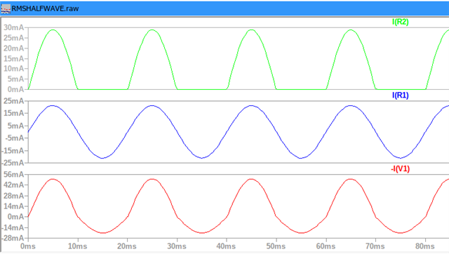

    you have defined exactly what you want, The sum of these upper 2 current traces, making the lower one
    We do not, however, as we have just discussed,  know for certain what the RCD spec actually means.
    Mike

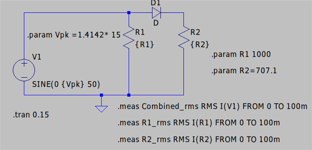

    PS for those interested, this is a simulation in LTspice, a tool I find helpful for this sort of stuff.
    This is the circuit being simulated.

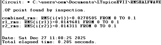

  • I have added the RMS calculations to the simulation above (and updated the screenshot image in the post above, to reflect that just in case someone else wants to know how to try this sort of thing at home ) and the combined RMS is not as low as you might think, coming in at almost exactly  27mA. - it is not simple power addition (which would be root of sum of squares - think Pythagoras) because they are synchronous functions, - that is to say the peaks of the rectified and un-rectified waveforms are always aligned, and  not independent of each other and those peaks, while only there half the time, count for most of the RMS energy.
    The spice log is as follows.
    I appreciate that there are quantisation errors, so the nominal 15mA RMS in the 2 limbs is not quite, but this still illustrates the point

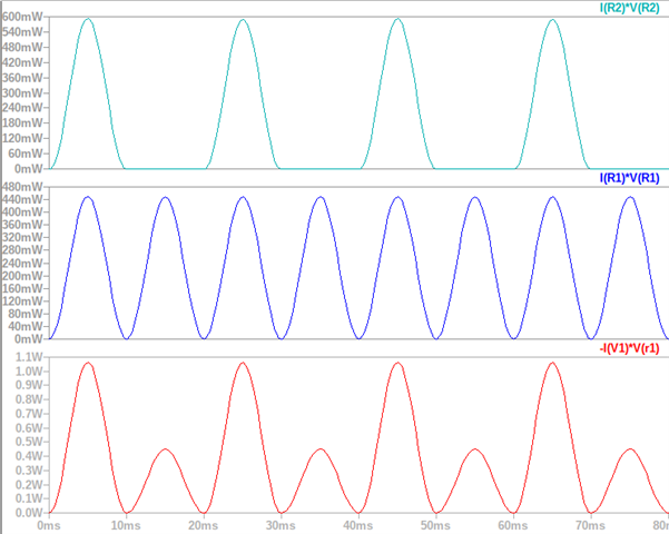

    It may help to visualise this by considering the power as a function of time, rather than smoothed over many cycles,
    regards
    Mike.
    PS schematic edited to create named nodes r1 and r2 so that we can plot the current in the component times the voltage across it with a meaningful name.

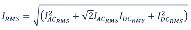

    I too confused myself. When adding full-fat and semi-skimmed currents, I forgot to take into account that the relationship between RMS and peak values is different, and accordingly, the equations of the sine waves are different.
    I now have 15 + 15 ≈ 27.7, which agrees with Mike's value, subject to "quantisation errors".
    I have re-done my algebra and find:
    So where both components are 15 mA, the total is √(2 + √2) x 15 mA ≈ 27.7 mA
  • That is a reassuring result, and yes, pythagoras plus the cross term that makes all the difference looks right to me. I'll allow the 700micro-amps as the sort of thing that LT spice does not get right when it does its 'join the dots' integrations rather than  the pure maths. I will own up to being very good at losing factors of pi, 1/e and so on, when I do algebra under pressure and therefore I often use numerical tools like LTspice and others as a means to get close enough, when perhaps I should be reaching for a pen and thinking more.

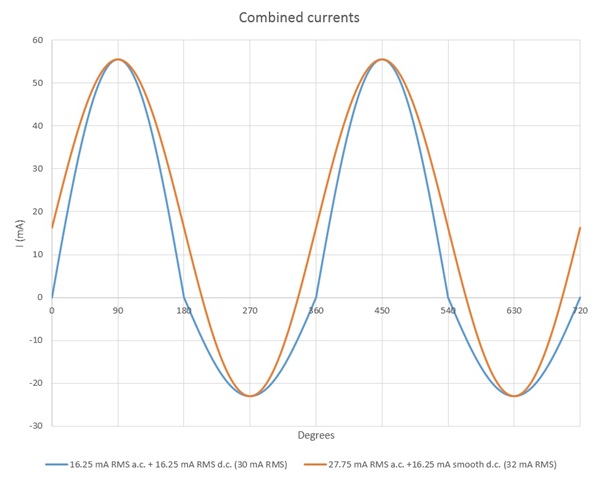

    Here we have slightly more at 16.25 mA  a.c. + 16.25 mA d.c. because the combined RMS is 30 mA. So, I thought let's get as close as possible with pure a.c. Problem is that the average current > 0, so it is necessary to add a little smooth d.c.
    The graphs look pretty similar to me, but would either (or both) trip an RCD?
