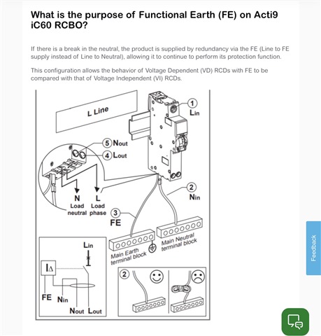

  • My thoughts revolve around the differences between voltage dependent and voltage independent RCDs, and RCDs with or without a functional earth lead.
    (not to be confused with voltage operated ELCBs...)
    With a FE connection, the RCD should still trip if the supply N is lost (and L and PE remain) but I don't think that helps us with a solid N devices, as even if the device has successfully opened, there's still 230V between load N and supply L.

    Voltage Independent Technology
    Residual current devices using Voltage Independent Technology can continue to operate in the event of a complete voltage loss or neutral break.
    • The toroid provides information on the leakage current and the power required to trip the device.
    • The electronic circuit and the relay are not connected to the electrical network. Power is provided only by the leakage current.
    • Even if there is an accidental break of the neutral conductor or a voltage drop, the entire electromechanical system will continue to operate, allowing the residual current device to trip.
    www.se.com/.../
