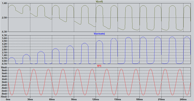

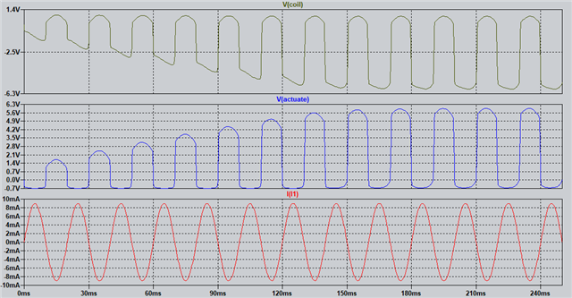

  • Mike is along, and I agree, that is not a normal rectifier - the actuation coil does not see a steady DC, rather something the is almost zero on one half cycle, and quite noticeably negative on the other. Waveforms in microwave ovens are similarly odd.
    other phase start

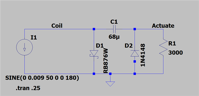

    The model. Note if D1 is not a zener then the voltages reached mean the sensing core would saturate horribly - perhaps it does but has already de-latched by then; as it is the integrals are not nice.
      I chose 10mA p-p as being about 3.5mA RMS ,a little over 1/12 of 30mA. The actuator coil resistance is a total guess, but it only alters the amplitude a bit, not the trend we want to understand, that it is not really a rectifier in the normal sense, more of a single sided pulsar.
  • Note if D1 is not a zener then the voltages reached mean the sensing core would saturate horribly

  • So, I made a mistake. D2 is anti-parallel with D1. Thus the solenoid is fed via C1. Makes more sense,
    Though the capacitor reliability may take a slight hit. 99.9% of the time it'll have micro/milli volt signals as the potential 1mA AC (equiv 12mA leakage) keeps tickling the diode forward biases.
