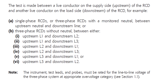

    I'm not so sure this is correct for all testers ... because the test method is also valid (if the test equipment is so designed) for testing three-phase RCDs in systems with no neutral, where only a downstream and upstream line conductor are available. Guidance Note 3 says the following:
    An example of test instruments that follow (b) in the clip above from GN3, is the Megger 1730 and 1740 series that are rated for three-phase systems (I understand some models are only suitable for single-phase circuits) ... but other testers with equivalent features in this regard are available of course.
    Such approach does not leave the tester quite as safely 'isolated' so more caution is needed by the operator.
