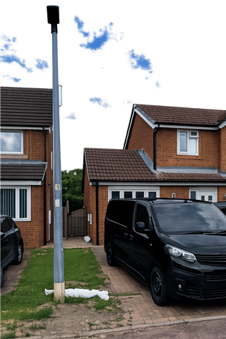

I am seeking the collective views of the group regarding the issues we are currently encountering within the EV installation environment in relation to simultaneous contact.
In simple terms, we are seeing a significant number of installations where customers have lamp posts located within their driveways. In many of these cases, it is not possible to achieve the recommended 2.5‑metre separation distance.
My position is that, where physical separation cannot be achieved, the application of layered protection at the EV charge point and associated switchgear would leave the customer in no worse position than prior to the installation. It is accepted that the proposal only outlines protection on the vehicle, but there are no other solutions for industry, are we with the protection detailed taking enough measures to carry out an install and in affect leave the install without a subsantial increase in risk?
My proposed approach to managing simultaneous contact risk would follow a structured hierarchy as set out below:
  • Can the maximum separation distance be achieved?
  • Can barriers or enclosures be installed to prevent simultaneous contact?
  • If neither of the above options are achievable, can layered protection provide an acceptable level of risk mitigation?

    The recommended approach here is to contact the DNO/IDNO and ask them if the two properties and lighting column are connected to the same earthing system before deciding on anything. With cross-pavement charging, this is only going to be a more frequent issue.
    In this particular case, I'm guessing it may well not be permitted to erect a fence or barrier due to either planning constraints, or covenants or other terms in the deeds.
    As a last resort, A722.5 provides a solution, but it's not cheap, might have inrush issue, and might take a lot of space.

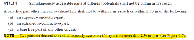

    The clarity is provided in BS 7671 (and IEC/HD 60364 series, IEC 60364-4-41). It could not be more plain.
    Simultaneously accessible is explained quite clearly in Regulation Group 417.3, including Figure 417. The 2.5 m is clearly stated in terms of an interpretation of 'simultaneously accessible'
    The basic principle is in the NOTE to Regulation 417.3.2:
    We wouldn't ever use the 'average finger to finger span' but an arm span that a large percentage of the population is guaranteed to be under. The P95M (95th percentile male) value of arm span, means that 95 % of males will have an arm span less than the value, and that is 1.90 to 1.96 m ... hence, when calculations are carried out by DNOs for their earthing systems, which aligns with the approach for HV standard BS EN IEC 61936-1 and BS EN 50522, they will use a value of 2 m.
    However, the value in IEC/HD 60364-4-41 and BS 7671 is likely to be the P95M arm span, holding something conductive of length 250 mm ish in each hand, or holding something conductive of length up to 500 mm in one hand.
    Don't forget, HV standards for touch/step potential are usually mainly applied within the boundaries of substation fences (or similar) where only skilled, instructed or supervised persons, wearing appropriate clothing and footwear, are intended to be present. BS 7671 on the other hand has to be suitable for 'ordinary persons' for the most part.
