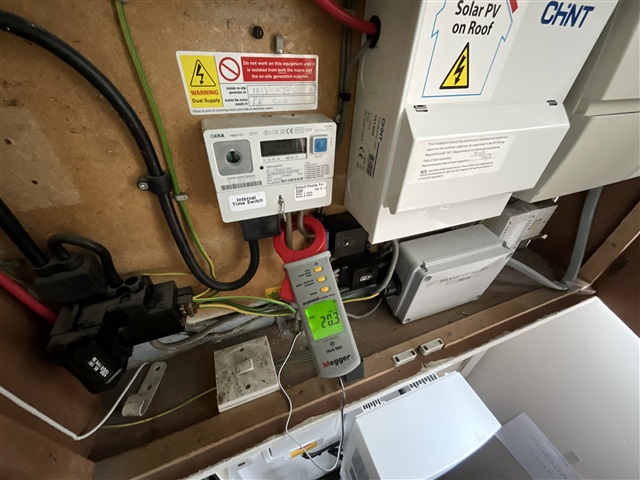

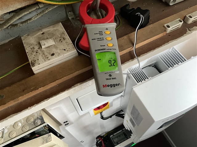

  • So we keep a record of leakage on every inspection we do. This one is fairly typical of what we are seeing in a small single phase installation. All circuits on, but not necessarily with load. Top photo complete installation, bottom photo measuring separate tails to the PV board which then supplies the inverter.
