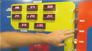

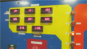

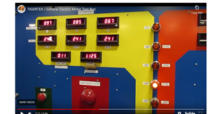

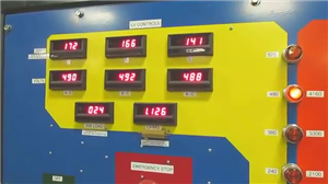

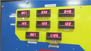

    The TigerTek motor test indeed was very impressive.
    Certainly a great bit of kit they had!
    Interesting though that on 120v each phase is drawing almost roughly the same current A57, B50, C49.
    Stepping up to 208v it's A76, B65, C61 so again virtually the same on each phase....
    At 240v however it then begins to alter ?? A86, B74, C68
    At 380v it's..... A134, B121, C103
    At 480v, A172, B166, and C141
    All voltages are almost the same, BUT phase C's current draw seems way lower compared to A.
    Does anyone possibly know why A was pulling far more current, than C?
    Is that normal??
    It seemed odd to me, A taking mostly the highest load current.
    That would mean A is loading far more than the others which could result in a premature failure.
    I thought the whole point of 3 phase was that each phase loaded equally, which thus providing a balanced power loading?

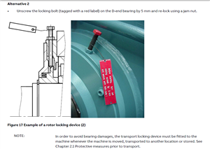

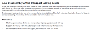

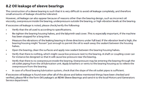

    ABB have been superb, and sent over a superb PDF motor manual which gives tons of info, here are a few screenshots of stator and rotor winding checks, and also brush pressure.
    It does also mention anti-condensation heaters and temperature sensors too.
    Additionally it mentions oil leakage and the possible causes!
    Certainly a superb manual.

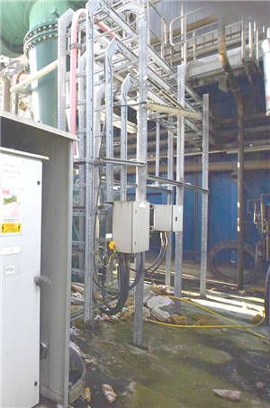

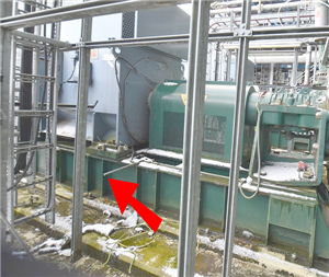

    I have no idea as to how the motors were disconnected, if the power station engineer did that or it was done by the demolition company.

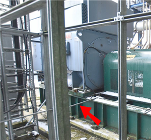

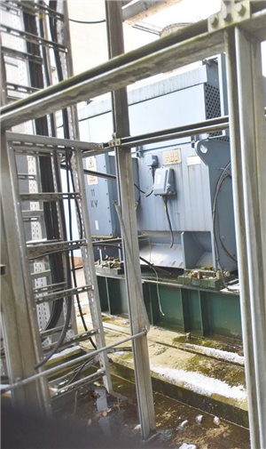

    Worryingly, lot 9 shows a small conduit feed intact:
    Possibly a sensor line or some low voltage feed, anti-condensation or temp control maybe.
    However lot 10's conduit has been sheared off......
    The motor's frame bolts have also been undone.
    Look closely again at these two pictures.... and both shows other cable lines cut.
    It would appear that (maybe) most have been 'pruned' with no regard for the reinstallation of the machine.
    If it was a feed into the actual plant then sobeit, but if just to a nearby controller box or sub-unit then the entire cable (or cables) will all have to be replaced (at extra cost), when they could have been simply disconnected carefully from one side and easily reconnected again at the new site.
    Could also be a major problem if associated equipment and/or panels/boxes are removed or even lost.
    It may not be possible to easily reinstall things properly!

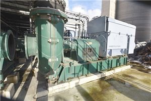

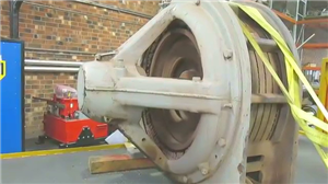

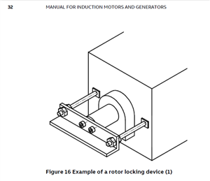

    Looking rather a mess... and it seems reading the manual the cooler unit (topbox) was delivered separately on any initial motor installation, so possibly that should come off before the motor is even lifted out.
    The entire motor (as it sits on the concrete pad) wasn't designed to be craned out in one go.
    Hopefully someone doesn't attempt this, or the base frame could get badly bent.....
    Worse... one of the eyebolts breaks from an overload
    OR the cooler is pulled apart from the motor, and the motor then drops to the ground.

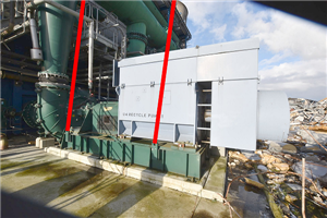

    Can't sleep so having restudied further the photo of the green main frame, I think even IF the unit could be lifted directly straight upwards (which doesn't seem possible due to the overhead pipework), it will end up tilting backwards and then drop down onto the rear end, possibly wrecking the topbox cooling unit.
    It appears to me that the motor was put on last, so for removal the topbox cooler indeed has to come off first, then the main frame could be balanced properly .....but maybe the motor still has to also come off, and only then can the main frame be lifted?
    If the motor transport locking devices must be active BEFORE moving the motor, they can only be accessed really once the topbox cooler is removed anyway.
    To me, it doesn't look like the unit can be lifted up (as it is) in one piece, but judging from and looking at the photos.... with cut cables, it appears (maybe) to be exactly what someone is trying to do?
    What does everyone else think?
    The rear lifting eye point is NOT at the far end of the actual green main frame - which surely with the cooler unit thus makes it heavy in the 'ass'!
    Is it likely to tip back, or actually remain level?
    While the pump is quite a heavy unit, that big motor I'm sure weighs far more to cause a rearend imbalance drop....
    Were the liftpoints on the green frame actually designed to lift the ENTIRE unit as it is, or simply to align the frame properly onto the concrete foundation bolts.
    I somehow think the frame was put in first.
    Then the pump fitted on.
    Then the motor.
    And finally the cooling topbox.
    Any thoughts?

    Having looked closely at the photos, the 11kv line appears NOT to come in via the red tubing conduit (as I'd previously thought!) red as a good warning for HT lines.
    The 11kv seems to be routed loose along the cable channel frame, into a cabinet to the right of the capacitor cabinet?
    Certainly an emergency stop switch there, with a further smaller cabinet to the side.
    Strange.
    In another photo the motors 11kv terminal box can be seen but no thick 11kv wires anywhere.....?
    But again, many cut or sheared through smaller cables.
    Two terminal box cables on the motor also cut through.
    Yet more undone frame bolts!
    I'm certain now, someone is getting ready to then lift out the entire unit as a whole.........
    Not good?

    Yes I noticed the variation in current on the tigertek rig - I presume that is why the motor is there to be fixed, it may mean there is a winding or an alignment fault, or the calibration on the rig is  bit off, or less sinsister, perhaps there are unequal resitances in the hook-up wiring. (though the secondary currents will be pro-rata less, the odd ohm astray could be problematic.)

    No bearing locks fitted, and so who knows what condition the unit(s) would be in on collection.

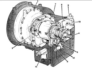

    He determined it was a later type and was fitted with a torque converter (no clutch) so DO NOT attempt to start the engine!
    Why (I said) as everyone usually just did exactly that!
    Because (he said) the TC is directly connected to the engine and there's thus no way to stop it turning over when the engine is from the starter.
    Basically it's a vital part of the machine, and was designed to allow a fast forward or reverse shuttle (thus avoiding clutch wear) with a gearbox behind it then allowing for selectable drive speeds.

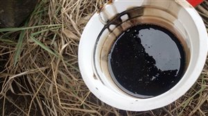

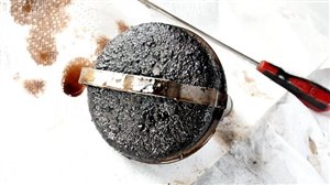

    So, with no other option I did as he'd said....and first drained the TC's transmission oil
    Certainly awful - and not the lovely cherry red that Dexron should be!

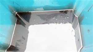

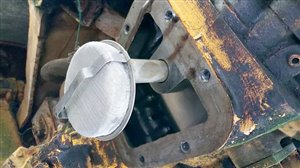

    Next the sump removal and to check that strainer...
    TOTALLY clogged up, just as he said!
    After a good clean, this is what it should look like
    Wow, just a few minutes work being careful, and that DID likely save the entire transmission system!

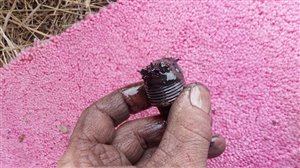

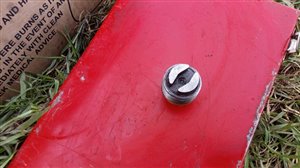

    AND check the sump plug, he advised
    Loads of ex-gear metal filings stuck onto the magnet.
    But easy to sort that out
    and now it's ready to pick up any other loose bits!
