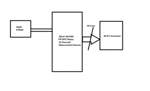

Hello,
We have a Insulation Resistance measurement unit from Hioki - ST5520.
We are using this to measure multiple devices controlled through a relay matrix as shown in the figure. The positive and negative terminals of the ST5520 is multiplexed through the relay matrix to the 64 pins of the connector. There are 7 pcb's each containing 20 relays.
The individual board testing from ST5520 to the connector is giving a open condition result with a high value of insulation resistance of 9.90Gohm @1000V, when there is no load at the connector output, it is left open.
But the when the whole system is wired and tested with the 7 pcb's(all 32 channels), the value fluctuates and starts with a value from 100Mohm and eventually reaches open condition value.
Is there a problem with this process of multiple channel testing? or this is the expected behaviour? the open condition value(9.90Gohm@1000V) is maintained once it reaches this value and further tests result in this same value.
Once the system is left OFF for a period of a day, then the testing is resumed again, the same behaviour of starting from 100Mohm to open condition value repeats. Is this to be expected or i am understanding/ doing something wrong?
Any help with this is much appreciated. Thanks in advance.

  • starts with a value from 100Mohm and eventually reaches open condition value.
    sounds to me that either there's some damp in the system that's being dried out by the test voltage (probably unlikely) or that all the PCBs and relays are acting as a reasonably large capacitor that takes time a charge up from the limited IR meter test current (possibly more likely). If it were the latter problem I might expect the 'slow ramp up' problem to return immediately if the IR meter's +ve and -ve leads were reversed (all presuming it's a DC test current).

  • Former Community Member
    0 Former Community Member
    Thanks for the Reply.
    At any point of time only a single channel connection is propagated from ST5520 to connector, so dont think that we are measuring multiple resistances.
    The connection is not propagated to multiple channels. This is what you meant when talking about multiple parallel resistances right? even if the signal is propagated through multiple channels the end connections are open with no load, so i think it should still show open connection, am i wrong to assume that?
    Initially we also assumed that former condition you mentioned and took steps to avoid that, but the result was still the same, so that is ruled out.
    will check and get back after testing the reversal of +ve and -ve leads.
    Lets assume that the large charge up is the problem, is there a way around it? Right now the time it takes for the ramp up is rather large.

  • The only question is "what is the pass IR value in the test spec?". As soon as this is read by the computer you go on to the next path. The actual value doesn't matter, only that the pass value is reached. This should enable you to flash through all the tests in a few minutes. The reason it takes time to get to the GOhm region is because of something called "dielectric absorption", but it is not really related to the IR measurement. Your insulation tester is providing a few microamps to do the test, and this is effectively the time constant of the capacitance you are seeing.

    davezawadi (David Stone):
    Edit: Explaination added
    Regards
    David CEng etc.
    Thanks for the reply.
    Yes, read about "dielectric absorption". So we waited to measure the time taken to reach a high value. But the issue is that the time it is taking to reach a high value is in the range of 10-20mins approx for each channel. This is producing a huge overhead. The loads to be measured has an optimum IR value in the range of several hundred Mohms to 2-3Gohm, so the pass value should be higher than this to accurately measure the readings. So due to the large time taken for the pass value , the "dielectric absorption" doesnt seem to answer the issue completely. or is my understanding incorrect and the time measured is the actual time taken and will always be present? If so is there a way to reduce it?

  • At 1000V you will be seeing all the effects insulation can throw at you in everything, the PCBs,  the relays, perhaps the flux used to solder the PCBs, and any finger prints on the exposed ends of wires -  everything will matter at this level of resistance - to get the best part of 10 gig-ohms, you are asking for  something like 100nA or less to flow, now that  that is a mere 10^12 electrons per second. - what area of insulation are you stressing -  each atom is ~ 250pico metres radius, or if you prefer to think of it as atoms, then each square mm of insulation to live metal interface exposes about  16 million million atoms, it is not reasonable over many hundreds of square mm of contact area between insulation and  live metal not to expect a detectable percentage of the atoms to have either a free electron (steady leakage current ) or a slightly wobbly one (slow polarisation and dielectric recovery)
    If you really do need to measure giga-ohms on the test specimens, then you need to be gapping the insulation to give longest possible creepage paths and large clearances to keep the E field down, cleaning everything till it gleams, baking it to drive of moisture and then encapsulating as much as possible in HV laquer, or alternatively after cleaning and bake off, doing the whole test in vacuum.
    Can you test at lower voltage ? - if the resistance looks higher , you may also be suffering the onset of corona discharge to the air. This can be tracked down, either using a MW radio, or a UV detector. (or just hopefully polishing off all surfaces that are not smooth - cut wire ends make quite good needle electrodes.)
    But before all that, as others have said, check if you really do need to measure 10 gigohms, or if a lower pass limit can be set - a few million ohms is normally OK for a  a wiring installation, and much easier to handle.
