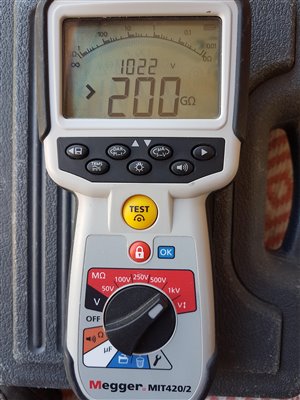

  • Hands up I was having a moment there, I cannot say I have actually ever worked in giga ohms.
    As I said above I have a tester capable of testing to 200 Gohm, but it's not something that I need to concern myself with.
    I am reading one of the Megger guide again and it says that OL or whatever is shown as the upper limit of the meters range is not a reading,  merely an indication that the true reading is beyond the capability of the tester.

  • It was easy to get the tester to display 200 Gohm, I didn't plug the leads in.
