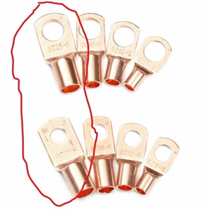

  • Far too rough attempting to wind 10mm2 conductors round BS951 bonding clamp connection lugg.
    Try this:
    Legh

  • full 10mm around (approx 180 degrees) always.
    Even do that on last one (or the only one) unless using a eyelet crimp, kwick turn on end - prevents puill out on loose screw.
