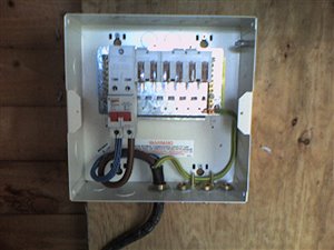

Hi was conducting a EICR on a consumer unit today removed the cover and Main earth cable was 8 x single strand insulated cables istead of expected single 25mm also earth was the same??? it is in an apartment and has been running fine for
at least 20 years, just want to know what to input for csa?? and should I note it in observations under C3 CODE???? ANY ADVISE WELCOME THANKS

  • Sounds like a split concentric cable which if this is the case then perfectly acceptable.

  • If it looks a bit like this stuff. then as others have said,
     It is split concentric cable - common for use by DNOs, not quite as good as SWA as there is not an overall earthed armour - half of the 'not really an armour' is neutral. but easy to work with and good for EMC. Can be buried, but needs to meet the same routing rules in walls like T and E to meet BS7671.
    CSA is normally stamped on the jacket, but if not, size from the live core, N has slightly more current handling capacity, being better cooled

  • Another example. Now discuss if this is permitted because I won't.
  • istead of expected single 25mm
    As it's an apartment, I wouldn't be at all surprised if it was fused down after the cut-out - and thus a smaller size could be expected (often 16mm² perhaps even 10mm² if the load was expected to be modest).
    Split-con often used to be used in place of SWA (as it's much easier to handle and terminate), but has a few disadvantages for modern requirements - firstly much of the "armour" is N rather than PE, so it's not suitable for avoiding 30mA RCD protection when concealed in a wall or similar - so basically treat it as if it were T&E rather than SWA. Also some care is needed with fault protection - since the plastic covering on the individual strands of the N mean that fault currents aren't necessarily shared between all of the strands if the fault occurs before the final terminal, unlike a normal stranded conductor, so you might want to think about  fault protection of conductors in parallel (e.g. appendix 10 of BS 7671).

    I asked where the meter is with the intention of trying to determine if the cable should be classified as suppliers equipment or part of the consumers installation, the next question is what fuses are installed to protect this cable, is protected by the suppliers fuse or a fuse within the consumers installation?
  • Andy raises an interesting point - what do you need to consider for fault protection (adiabatic) in this case?
    It's entirely possible (and perhaps more likely) that a line to neutral or line to earth fault will only short line to a single strand of the neutral or earth (or perhaps a few strands).
    In a 25 mm2 split-concentric cable, the equivalent CSA of each neutral strand (11 x 1.7 mm) is 2.27 mm2, and that of each cpc strand (4 x 2.25 mm) is 4.0 mm2.
