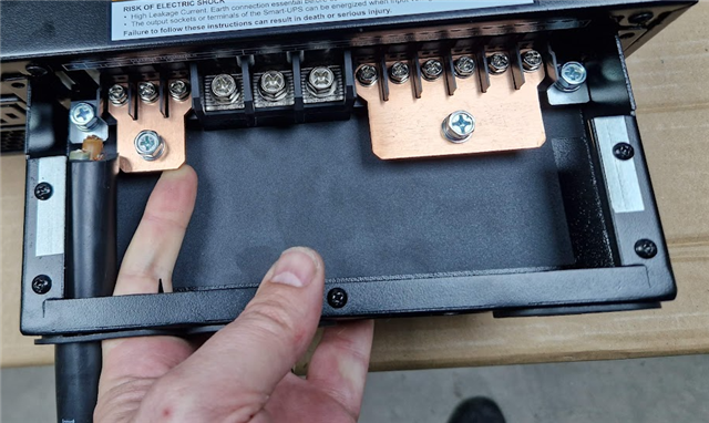

Got a new piece of equipment to be fed from 63A/80A single phase supply. Requires at least 2x 3C cables entering sized at 16mmsq (H07 type).
Glands wont fit, no cable strain relief...
Thoughts appreciated.

Might be just about acceptable for fixed equipment, if the cables are fixed to the building fabric just before entering the equipment. No worse than the supply end of the cable terminated into the average consumer unit.
Not in my view acceptable for a portable appliance.
Doesn't look to meet the IP2X requirement normally needed for enclosures if a finger can reach live parts like that. (Although some equipment standards occasionally have differing requirements.)
I'd suggest having a word with the supplier/manufacturer, or failing that replace those grommets with something with smaller holes, if needs be sandwich the existing wall with a couple of sheets something with a holes appropriate for stuffing glands (or smaller grommets) in them.
Where is it going - I may be happy with something like that pushed tight to feed into a section of trunking or something else with a tight gap, or perhaps out of reach or in a locked box but on its own it on sitting the table top it looks 'finger nippin good' to paraphrase the KFC chap..
And also what holds the lid on ?

I have struggled to find glands that will suit the required cable size and available hole size. Looked at manufacturing a new terminal box but can't as it would block access to other parts of the equipment.
agree with your unease.
If the makers are not helpful then how about fitting some stuffing glands that suit the cable into a metal or thick plastic sheet that fits inside the box to make a giant rectangular washer?

Thanks for the suggestions. I thought about the metal / plastic sheet inside the box. From memory the 3c16 cable are 28mm diameter, the cable entry box is 35mm deep. The gland required is 40mm and the internal gland nut is 55mm across flats. Not enough room.
I have considered using 6x1c double insulated singles (probably H07 again) but even that won't comfortably fit. I have at least 2x 3c cables to go into the equipment. I don't like using singles in this type of install either. Looks poor, costs more and takes longer. However sometimes you have no choice!
I believe this type of kit has been installed inside another locked power distribution enclosure before, using external strain relief, and I could just about accept that.
This version is stated as being able to be installed free standing or in an IT rack. I don't agree with the manufacturer on this and I am gathering opinions just in case I am being unreasonable..

A bit of 4" trunking and paxolin between the two. Couple of end caps, and bobs your uncle...........I wouldn't accept it installed like that all.
Again, good suggestion, but the trunking large enough for the cables would be bigger than the 38mm cable entry and would block access to parts of the equipment. I would not be able to use this method if installed in an IT rack either (though hopefully that won't be very often).
