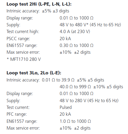

  • I'm not  familiar with that tester but looking at the Meggar website
    https://www.megger.com/sites/g/files/utfabz201/files/acquiadam_assets/2023-07/MFT1711-MFT1721-MFT1731-MFT1741_DS_en.pdf?changed=1739442054
    we see
    So on the hi  current 2 wire range, that reads 0.01 minimum, that could read between +/-0.03 ohms plus 5% of reading, so a reading of 0.77 could really be anything between 0.68 or 0.82, Had the other set of readings been within a few % of this band I'd have been muttering about 'identical within tolerances' but really this is not.
    Eliminate the obvious, dirty probes, poor contact between probe and circuit or probe leads and the meter itself etc, if you have not already one so.
