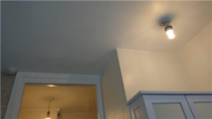

Hello, should a lamp without a diffuser outside of zones 0-2 in a bathroom be classed as C2 or C3 on an EICR?

  • Neither provided that there is RCD protection.
  • Agree, some people prefer an enclosed fitting in a bathroom, but nothing prohibits use of a batten fitting with a GLS lamp or low energy alternative.
    Such fittings used to require, and AFAIK still require to be fitted with a "home office skirt" this to prevent easy contact with the metal lamp cap.
    The light pictured is so equiped.
    BTW, the requirement for a "home office skirt" was one of the few electrical regulations introduced by HM government, and not by the then IEE.

    If the EICR is for rental purposes then all pecautions need to be observed as it is a business venture.
    If its for personal use then HMO skirts are fine. You actually have to do alot of mischieve to receive an electric shock from a B22 fitting  without a HMO skirt.

    It's a rental property... so you'd class it as C2 or C3?
  • Out of zones, the assumption is it will  not be splashed, so really no code, C3 if you must - yes its a bit rough, but it is not breaking any regs in BS7671.

  • For rental properties
    Class 2 without a RCD
    Class 3 if the fitting is outside the zones, looks old or not to IP2X
    Otherwise no comment

  • I think the potential issue if any is that it doesn't have a back plate. It is screwed strait to the ceiling so the connections in the back could be stuffed up into the ceiling void although i presume you checked that.

    What about the light fitting in the shower cubicle? ..... that's the one to the left ....

    Isn't that a pendant in the entrance hall or landing seen in a mirror?
