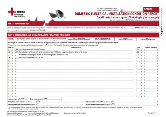

Hi, I have received an EICR certificate with 2 C2s on bathroom lighting 1) Bathroom lighting does not conform to IP rating (note the lighting outside the zone based on published zoning guidance (low voltage spot light) but inspector insisted on ignoring the zoning guidance) 2) Bathroom lighting circuit is not connected to an RCD also supplementary bonding is not visible.
Questions- 1) Are the C2s legitimate? As a layman, I find it difficult to understand why the inspector insisted on ignoring the bathroom zoning regulation (my ceiling is actually higher than most of the newer flat) . 2) Also how do I find out whether there is supplemental bonding in the bathroom lighting circuit (nothing is visible outside) - does it really warrant a C2 if I cannot prove that there is supplemental bonding (the lighting in my bathroom is low voltage (I don’t know what is the voltage but it is very dim) and is located outside zone) . 3) If the C2s are legitimate, how can I fix the issue with minimal cost?

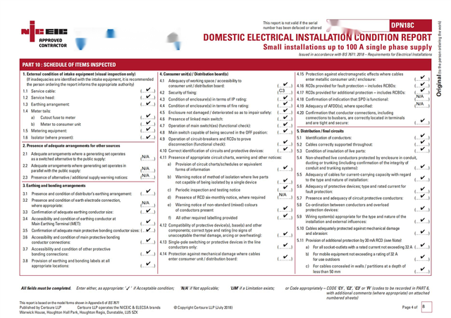

  • Part 10. No. 8. RCD for low voltage circuits serving the location. "N/A" is not consistent with the C2 later on.
  • Thanks Kay76 very interesting. It has all the hallmarks of being entirely made up, because many items which should be N/A are ticked, the readings from measurements are not consistent ex. Circuit 5 (R1+R2 does not match alleged cable resistances) and appears to be an incorrect Zs value for the circuit, not matching the Ze value. I wonder at the Ze and actual supply arrangement too, where is your electricity meter? Do you pay the management company or the distributor directly?

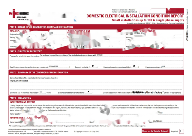

  • Just a few observations from me;
    page 2-Next inspection-1 month
    this really winds me up. If all remedials are done, the report should give a reasonable time until next inspection. As it stands, another report is needed after the remedials are done

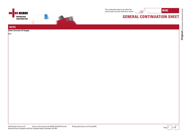

    other sources of supply on page 7, which says N/A

    page 4
    item 4.2 no mention elsewhere of loose CU
    item 4.4 should be C3, plastic CU
    item 4.15 should be N/A-plastic CU
    item 4.16 should be N/A- not required for fault protection, not TT and Zs within limits all circuits
    item 4.17 this is ticked but has given a C2 for no RCD in bathroom
    page 5
    item 5.11 e) shouldn't be N/A, should have a code
    item 6.1 b) ticked, but bedroom light not working?
    list of luminaires page 8, which says N/A so none inspected despite saying 20% in extent of sampling on page 3
    item 7.7 all N/A-should include those in bathroom
    item 8.1 a) says N/A, but has given C2 for this elsewhere
    item 8.2 says N/A but lights are ELV
    Note-his name hasn't been redacted at the bottom

  • I wonder if the eagle eyed have noticed something else? The incomer appears to be 3 core SWA (old colours) but where is the armour (see 5.16 on form)? This suggests that there is a central position with all the meters, and presumably the position of all the extraneous parts bonding (if any) and an easily accessed fuse whose rating is unlikely to be the 100A stated, providing protection of the submain which he says is 16mm2 (main Earth conductor, thus undersized! Now the hard question, would I expect this to be present within the flat too, as there is one 10mm2 in the CU Earth bar as far as I can see? How was this inspected because I would expect at least a note about it. The flat heating is also interesting, perhaps central, perhaps gas, or perhaps just a single heater or perhaps that is an immersion water heater? Then there are all the ticks on metering equipment and bonding all being present and the correct size, interesting. Yet he complains that the bathroom bonding cannot be verified!
    This is definitely an inadequate EICR, with all the paperwork from a scheme. I wonder about the qualifications of the QS and the Inspector. It needs to be taken much further.
  • Strangely the reading of 0.14 of an ohm in the photo of the "machine that goes ping" to impress the natives does not actually appear anywhere in the results.
    It could be ring round on red end to end circuit 5  test r1  later mistyped as 0.16  I suppose. That's implying a total wiring length of about 20-25m of 2.5mm core. That seems a bit short then but I suppose it maybe.a small installation. Once you start to wonder you see things, like that 949 kilo amps instead of amps it leaves you wondering how much thought went into this.
