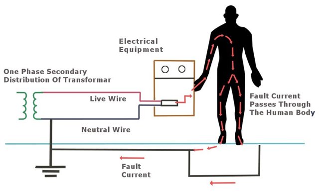

  • In terms of technical mitigation the problem is that with high CPC current the 'single fault' of loss of CPC continuity in the flexible lead would lead to an immediate danger of shock from the case of the equipment.
    Is there for example something that would allow an additional earth bond, so two independent things have to fail before there is danger, restoring a more acceptably unlikely level of risk.
    Does it need to be plug and socket, or could the wiring be mechanically fixed, or the plug locked in ?
    Ordinary persons become instructed, once they are aware of, and can understand, the risks.
    reading and understanding something like this would be a good start.
    https://kmelectric.com.au/importance-of-the-earthing-system/
    Then they need to know they should  report any tingles or other funny behaviour, and who to report it to,  and perhaps how to verify things are all right (how to check cables etc ) before plugging in .
    And you need to keep non-instructed persons away ;-)
